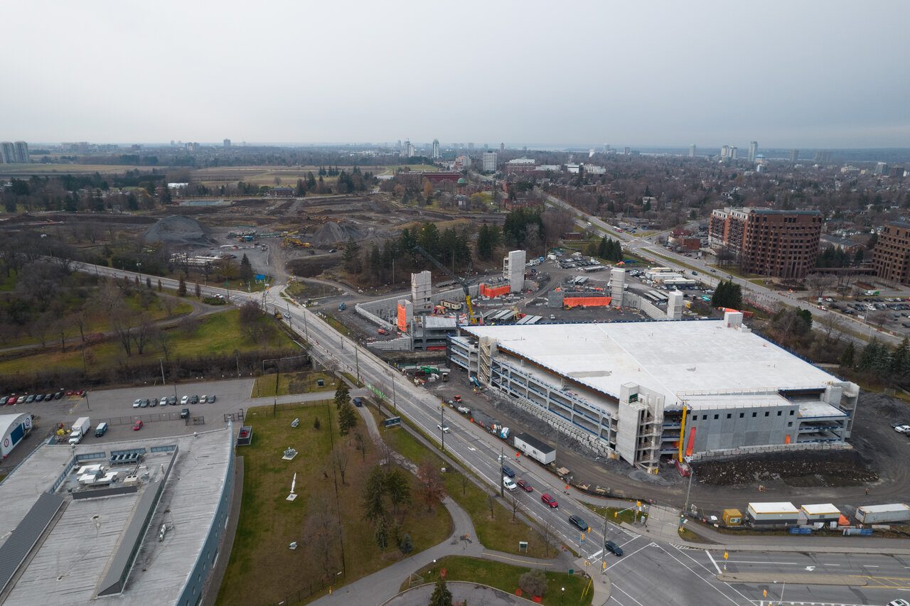

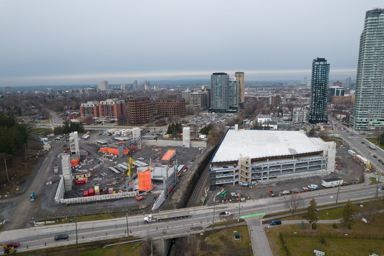

Not sure how they'll be bridging the two parking garage structures together. Not seeing any indication that they prepared for it. Also, not seeing a lot of progress since September.
Part 2 of the garage will be assembled pretty fast. I passed by monday afternoon and nothing was up yet. By the end of the winter I bet the rough will be all done, depending of the supply.

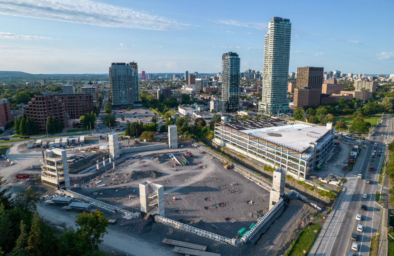

Is it just me or is the parking garage grossly overbuilt? The Ottawa Hospital on Smyth is quite large too and how many spots does it have in comparison to this one?
The General campus has a massive amount of surface parking in addition to it's parking garages.
Yeah, General Campus is massively car oriented. There's really no other practical way unless you live within a 15 minute walk or bike ride. The Civic's parking garage, though huge, is fairly compact compared to General/CHEO. Transit connection could be better, but it will be the best in the city by a long shot.
