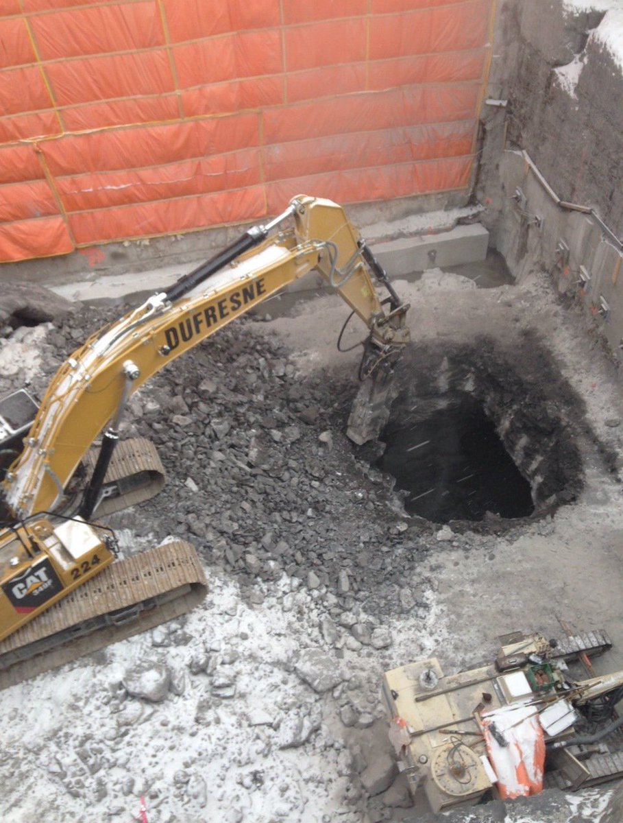

Breaking through to the tunnel from Rideau Station east entrance

Rideau Station east entrance: crews continue blasting, rock removals and reinforcing the entrance.

Breaking-through-to-the-tunnel-from-Rideau-Station-east-entrance-2016-02-11-1024x576.jpg
That's Rideau Station.
[edit] oops, I didn't notice that all of those construction update pictures had been posted already.

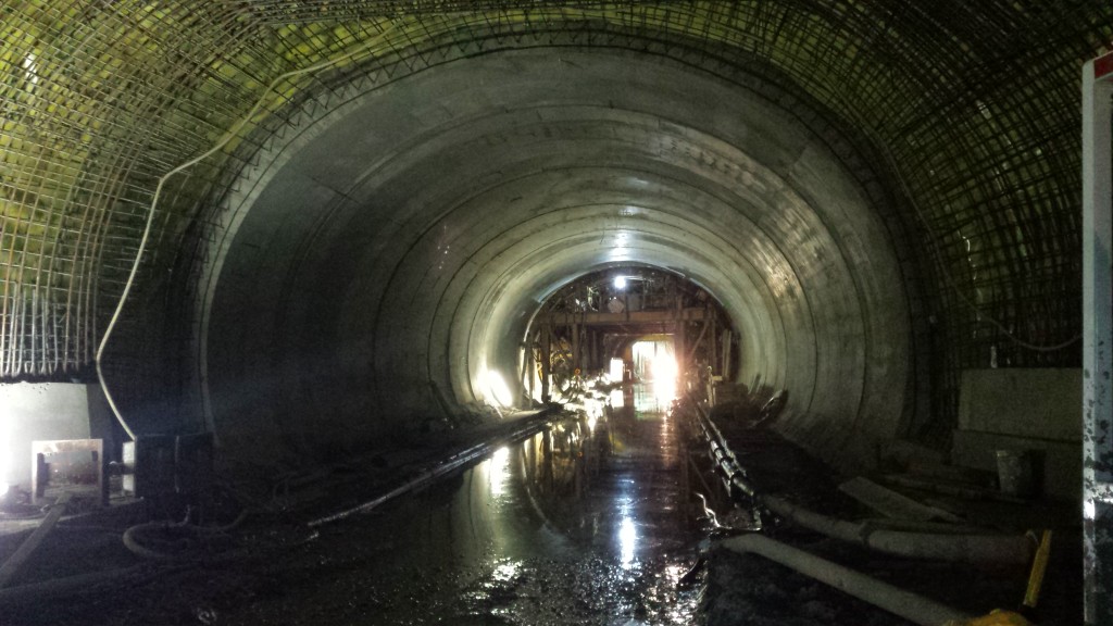

Some of the more interesting construction update photos from the past month.
East of Lyon Station, things are starting to look like a real tunnel!
Waterproofing-continues-in-the-transition-east-of-Lyon-Station-cavern-2016-03-30-1024x576.jpg

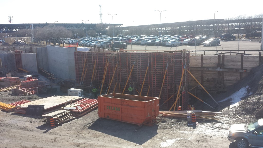

Tremblay Station is taking shape.
Most other photos are of yet more unfinished tunnel, or of generic construction activities that are generally unremarkable.
  • Waterproofing-continues-in-the-transition-east-of-Lyon-Station-cavern-2016-03-30-1024x576.jpg
